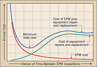

Several years ago, before deregulation was a twinkle in any legislator’s eye, Cleveland Electric Illuminating Co. conducted a study on maintenance costs compared with frequency. Fig. 1, which is reproduced from that study, shows the relationship between maintenance intervals and cost. If you’re starting a maintenance program from scratch, the initial costs are high due to the test equipment and tools needed. Once the program is operational, that cost stabilizes and becomes much less of a factor.
The study, which was conducted years ago, found that if maintenance programs are planned out properly and performed at the correct intervals, a preventive maintenance (PM) program can save a company as much as $5 for every dollar invested. The problem is this money comes from losses that don’t occur; breakdowns, overtime, loss of production and purchasing replacement equipment at premium prices. It often isn’t an item that can be pointed out to the accounting department.
