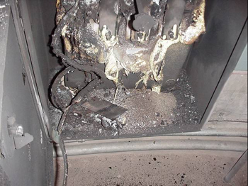

It’s impossible to prevent voltage surges from entering, or occurring in, a building, so SPDs must divert surges to ground. By design, an SPD is "self-sacrificing"—it removes harmful voltage spikes even under conditions that can cause its ultimate failure. The key is to ensure that in the unlikely event of its failure the SPD won’t trip the upstream protective device, damage equipment, or harm people. Well-designed SPDs are generally maintenance free and should last the lifetime of the facility.
Why do SPDs fail? Although failures are rare, they can occur if used the SPD is used incorrectly, for example, if a wye-configured SPD is installed into a delta system. They can also occur when the primary component—the MOV—is forced to sustain a temporary overvoltage (TOV). A TOV (up to 200% of normal voltage) can result from a utility fault, loss of the neutral on a 3-phase, 4-wire system, or an improperly wired device. Though not a surge event, improper wiring accounts for the majority of SPD failures. These occurrences gradually degrade the MOV, changing its resistance from megohms to milliohms.

Proper SPD testing promotes safety and reliability. SPD products that promote fuses with excessive surge current ratings don’t provide the proper system coordination. They sacrifice low-level fault protection and fail to disconnect during low-current faults. This can result in catastrophic failure—which can result in a fire—and tripping of the upstream breaker or fuse.

Thermal fusing. An overheated MOV produces sufficient heat to prompt a thermal disconnection. For small fault currents, or if the occurrence is over a longer period, the thermal fuse spring (TFS) will disconnect first. Some SPDs use a fuse trace (FT) and an MOV in series with a 30A or 60A circuit breaker. Those SPDs pass standard safety tests but may fail in real world applications. For example, if the fault current is less than 30A, the SPD might catch fire, but the circuit breaker won’t trip. SPDs designed with a TFS allow disconnection of the shorted MOV at the overheating stage.
