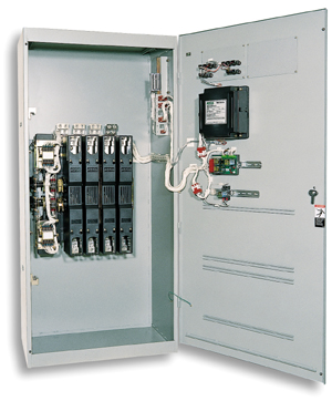

An automatic transfer switch (ATS) is a critical part of any emergency power supply system (EPSS). The ATS is the device that selects a power source—either normal utility power or standby generator power—and conducts the power to critical loads. The NFPA, Joint Commission on Accreditation of Healthcare Organizations (JCAHO), and all major ATS manufacturers publish literature calling for the monthly test of ATSs, yet many facility owners ignore these guidelines and refuse to perform the tests. There are good reasons for both the monthly-test requirement and for the reluctance of many operators to comply.
NFPA 110, the standard for emergency and standby power supply systems, states “the monthly test of a transfer switch shall consist of electrically operating the transfer switch from the standard position to the alternate position and then a return to the standard position” (Paragraph 8.4.5.1). The standard also requires a monthly generator run. The best way to perform both these tests is by operating the test toggle on the ATS when the generator isn’t running, and confirming that the ATS properly signals the generator to start and run before transferring building load.

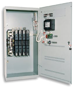

For new construction projects the issue of transfer-test-caused interruptions in power is an easy one to solve. The engineer responsible for specifying the electrical equipment should specify “closed transition,” or make-before-break, transfer switches. A transfer switch of this kind transfers when in its test mode, with no interruption in power. Switches of this kind were once a special product available from only one manufacturer, and they carried a daunting price premium. Today, however, closed transition transfer switches (CTTS) are available from several manufacturers, and at a very modest price premium over the old-fashioned open transition switch.
For existing facilities, a study should be done to determine which specific transfer switches feed loads that would actually suffer any negative impact from monthly interruptions in power. Those loads that are sensitive to interruptions can be protected with UPS systems, or with a timed pre-signal before transfer, allowing for orderly shutdown of the loads before power is interrupted. Also, existing open transition switches can be replaced with CTTS.
Any automatic transfer switch in an emergency or standby power system should be should be tested monthly in accordance with NFPA 110. That test should consist of an automatic generator start, initiated by the transfer switch, followed by an automatic transfer of facility load onto the standby generator. If power interruptions are a matter of concern, closed transition transfer switches should be used to eliminate the problem, or other methods should be used to mitigate the effects.
