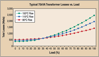

NEMA TP-1 compliant transformers have lower no-load losses than standard transformers and are therefore more efficient when the transformers are lightly loaded. Fig. 2 shows the losses of a 150°C rise NEMA TP-1 75kVA transformer compared to those of standard transformers and low temperature rise 75kVA transformers.
As you would expect, at the NEMA TP-1 conditions—35% loading—the NEMA TP-1 transformer is the most efficient transformer. In fact, due to its reduced no-load losses, the NEMA TP-1 transformer is the most efficient transformer for all loadings up to and slightly higher than 35%.
Fig. 3 shows the relative efficiency of a standard low temperature rise 80°C transformer compared to 150°C, 115°C, and 80°C rise NEMA TP-1 transformers. The reduced no load losses of the NEMA TP-1 transformers cause all three ratings of TP-1 transformers to be more efficient than the standard 80°C rise transformer. However, notice what happens when the transformer is loaded to 50% of capacity and higher, where the load losses have a greater impact on the overall efficiency of the transformer: the 80°C low temperature rise transformer is more efficient than the NEMA TP-1 rated transformers at high-load levels.
Many states, including Massachusetts, Minnesota, New York, and California, have passed legislation mandating the use of distribution transformers that meet or exceed the NEMA TP-1 efficiency standards. Installations in these states where the average loading of the transformer exceeds 50%, the use of NEMA TP-1 compliant transformers may actually cost building owners more in electricity costs than if they had installed a standard transformer with a 80°C low temperature rise.
In applications where the anticipated average daily loading of a distribution transformer is about 40% or less of the full load capacity of the transformer, NEMA TP-1 compliant transformers may be the most economical choice. Operations that run a single shift and are vacant overnight and on weekends should reap the long-term benefits of installing NEMA TP-1 compliant, energy-efficient transformers. In addition to the energy savings companies may receive by installing NEMA TP-1 compliant transformers, they may be able to take advantage of rebates offered by many local utilities and government agencies to customers who install energy saving products in their facilities. In many cases, the rebate is nearly equal to the difference in price between a NEMA TP-1 transformer and a standard 150°C rise transformer.

Examples of energy savings using different transformers. One way to evaluate which transformer is best for a specific application is to look at the costs associated with the transformer losses. Table 1 shows the losses, in watts, of low temperature rise energy-efficient transformers previously discussed. These are typical losses. Actual losses will vary from one manufacturer to another.
But what is really important are the dollar costs of these losses. The following equation was applied to the values from Table 2, then used to calculate the annual operating cost.
$ Cost/yr = ($/kWh)(1kW/1000W)(losses in watts)(24 hr/1 day)(365 day/1 yr)
The price of electricity varies across the country. In Table 2, a price of $0.08/kWh was used to determine the operating cost of these four transformers.
When operated at full load 24/7, the 80°C rise transformer costs $729 less to operate than a standard 150°C rise 75kVA transformer.
If the transformer is loaded at 35% of its capacity, the NEMA TP-1 150°C rise transformer is the least costly transformer to operate. The NEMA TP-1 transformer costs $98 less per year than a standard 150°C rise transformer, at $0.08/kWh. As the cost of electricity increases, the savings become even greater.
There are several different energy-efficient transformer options available in the market today. To determine which is the most cost effective for a specific application, it’s important to have a reasonably accurate idea of how the transformer is going to be loaded. When a transformer is going to be lightly loaded, a NEMA TP-1 compliant or 115°C low temperature rise model is likely the best option. On the other hand, when the anticipated load on the transformer is going to be in excess of about 50% percent of its capacity, an 80°C low temperature rise model is likely the better choice. However, local ordinances, building codes, energy codes, and legislation may limit the available options by mandating the use of a specific type of transformer.
