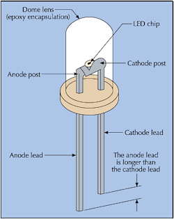

The centerpiece of a typical LED is a diode that is chip-mounted in a reflector cup and held in place by a mild steel lead frame connected to a pair of electrical wires. The entire arrangement is then encapsulated in epoxy. The diode chip is generally about 0.25 mm square. When current flows across the junction of two different materials, light is produced from within the solid crystal chip. The shape, or width, of the emitted light beam is determined by a variety of factors: the shape of the reflector cup, the size of the LED chip, the shape of the epoxy lens and the distance between the LED chip and the epoxy lens. The composition of the materials determines the wavelength and color of light. In addition to visible wavelengths, LEDs are also available in infrared wavelengths, from 830 nm to 940 nm.
