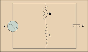

Resonance
As with series circuits containing resistances, inductances, and capacitances, if the inductive reactance of a parallel circuit equals the capacitive reactance, the circuit is said to be resonant at that frequency. A common example of parallel resonance is a tuning circuit, as shown in the Figure above.
In practical tuning circuits, the resistance in the capacitive branch is negligible, but the inductive branch has a considerable resistance due to the windings of the inductor. For the circuit shown in the Figure, if the inductance is 10 mH, what size capacitor must be used to cause the circuit to be resonant at 20.6 kHz?
To achieve resonance, the inductive and capacitive reactances must be equal, or
Substituting values yields
To finish, solve for C
or
The combination of the 10 mH inductor and the 6,000 pF capacitor is resonant at 20.6 kHz only. For any other frequency, the two reactances won't be equal, so resonance won't occur.
