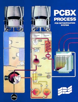

Hot oil reclamation
The purpose of hot oil reclamation is to prolong the life of the transformer. The process removes water from the oil and the windings; acids, alcohols, dissolved gases, oxides, and other decaying byproduct contaminants from the oil; and sludge layered within the coil/core assembly and the radiators.
On-site transformer oil treatment is possible using a hot oil reclamation processing (HORP) rig, which connects to the energized transformer with two sets of high-pressure hoses (Fig. 1).
The system circulates the hot oil in a closed-loop path. The reclamation process can be broken down into six components: heat, centrifuge, fuller's earth, vacuum degassing/dehydration, inhibitor, and filter stages.
Heat
The first step is to heat the oil when it enters the HORP rig. This process will help remove water adsorbed in the paper insulation and dissolve the sludge into a soluble form. It's advantageous to perform the reclamation process on an energized transformer. The heat generated by the load will aid in transferring the moisture from the paper to the oil and dissolving the sludge buildup internal to the core and coil assembly. The mechanical vibration at 60 Hz also aids in the circulation of the oil to help remove the sludge within the windings.
Centrifuge
A centrifuge isn't always necessary, but it can aid in the reclamation process by removing excess moisture and extracting insoluble contaminants like water and carbon. A centrifuge can dramatically decrease processing time and save a customer money.
Fuller's earth
Fuller's earth is a claylike substance used for filtering that adsorbs water, acids, and other oil-decaying products. As the oil passes through the fuller's earth, the adsorption process will remove the dissolved acid, sludge, and water. The continuous circulation of hot, dry, clean oil through the energized transformer will also clean the transformer as it continues to dissolve sludge, oil-decaying products, and moisture from the insulation.
Vacuum degassing-dehydration
Before the oil returns to the transformer, you need to pass it through a vacuum degassing/dehydration column to remove moisture, oxygen, and other gases. It's important to continuously operate the dehydration column so that “wet” oil doesn't return to the top of the transformer.
Inhibitor
Transformer oil often includes an inhibitor additive, which aids in the resistance of oxidation. The reclamation process can remove inhibitor, so during the last pass it's important to add it back as the oil leaves the HORP rig and returns to the transformer.
Filter stages
Metallic particles can cause serious damage like transformer failure, so it's critical to include multiple filter houses throughout the HORP rig to prevent particles from re-entering the transformer. During the last step before exiting the HORP rig, the oil passes through a .5-micron particle filter to trap any remaining particles before entering the transformer.
