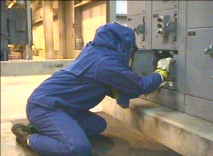

Understanding and identifying shock, arc flash, and arc blast is the third key electrical safety principle. Of these, electrical shock is the most common and well known. However, few are aware of the hazards presented by an electrical arcing fault and the resulting arc flash and arc blast, which cause severe electrical burns to more than 2,000 people in the United States each year.
An arc fault is initiated by current passing between two conducting metals through ionized gas or vapor caused by a flashover or other conductive material, such as a screwdriver. When an arc fault occurs, it produces an explosion with a significant amount of destructive energy.
The electrical arc produces temperatures that can exceed 35,000°F. This extreme temperature melts and vaporizes copper, which has an expansion ratio from solid to vapor of 67,000, as well as other materials. The high heat, arc flash, and molten metal can ignite clothing and cause fatal burns as far as 10 ft away. The vaporization and expansion of copper cause the arc blast itself, and the hot rapid-air expansion produces the immense sound and pressure waves as well as shrapnel. Pressure waves can rupture eardrums, collapse lungs, and propel workers across the room or cause them to fall from ladders. All of this occurs in a fraction of a second and will continue until the overcurrent protective device operates.

The fourth key electrical safety principal is to use safe work procedures, tools, and PPE. Electrical work must be planned before it is executed. All work procedures should be reviewed, updated, improved, and modified periodically as needed. For non-hazardous electrical work—equipment in an electrically safe work condition—the plan is typically unwritten but may be part of a general checklist and/or job briefing. For hazardous electrical work—energized or potentially energized equipment—a written procedure is usually required with documentation including a hazard/risk analysis detailing shock approach boundaries, flash hazard analysis, and a checklist of tasks.
OSHA 1910.333 covers the requirements for selection and use of work practices. The general requirement per OSHA 1910.333(a) is: “Safety-related work practices shall be employed to prevent electric shock or other injuries resulting from either direct or indirect electrical contacts, when work is performed near or on equipment or circuits which are or may be energized. The specific safety-related work practices shall be consistent with the nature and extent of the associated electrical hazards.”
The requirements for insulated tools, safeguards, and various types of personal protective equipment are detailed in OSHA 1910.335 and NFPA 70E-2000 Part II Chapter 3.
