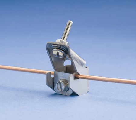

The ERITECH brand of solar bonding lugs from ERICO are designed to bond the frames and mounting structures of solar photovoltaic systems in accordance with NEC and UL requirements
The ERITECH brand of solar bonding lugs from ERICO are designed to bond the frames and mounting structures of solar photovoltaic systems in accordance with NEC and ULrequirements. These lugs are corrosion resistant and galvanically compatible with copper grounding conductors and aluminum photovoltaic module frames. They feature a unique offset angle, spring-held clamp and convenient lay-in feature to easily position the grounding conductor along multiple frames prior to securing the wire.
