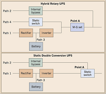

The Figure at right shows the principle building blocks of the two types of UPS systems, drawn on an equivalent basis in terms of major elements and conducting paths. The hybrid rotary UPS system incorporates two fully rated power paths that provide conditioned power to the load, while the static UPS system has one.
In the hybrid rotary UPS, the dual SCR bridge, 12-pulse rectifier provides current to the inverter when needed and simultaneously maintains the batteries at their full rated charge. Normally, the thyristor switch and motor-generator supplies the load, which provides regulated output voltage over a ±8% input range. When the main power source fails or is interrupted, the battery operation phase begins. As the output of the rectifier decreases, the battery supports the DC bus voltage and corresponding input to the inverter. The 6-pulse inverter is switched on to maintain power to the load by feeding the motor-generator directly, which, in turn, maintains a constant voltage to the load.
Similar to static UPS systems, the phase-controlled SCR inherently prevents battery current from flowing back into the main supply. In addition, the batteries support the inverter until the main power is restored. Unlike that of the static UPS, however, the inverter of the hybrid rotary UPS is off during normal operation, which means that the battery isn't subjected to the continuous AC currents caused by inverter switching.
In contrast to static UPS technology, which uses a single UPS power path that must operate continuously, the two-path design of a hybrid rotary UPS system allows it to operate from two independent power sources. In the hybrid rotary design, battery operation occurs only if both power sources fail. This can greatly reduce the number of battery discharges and increase battery life.
Because of power electronic component sizing, as well as the motor generator thermal withstand and energy storage, the hybrid rotary UPS design has greater overcurrent capability. Compared with the output of a static UPS that has a controlled inverter current limitation of about 2.5 to 3 times Inominal, the rotary machine output of the hybrid rotary UPS can typically deliver as much as 14 times Inominal inherently. This is particularly important in fault clearing circumstances, such as certain overloads or short circuits, and allows maintenance of full UPS function under these conditions.
