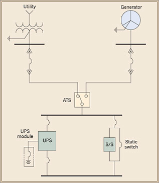

Sample exercise. Shown in Fig. 1 is the electrical one-line diagram for a simple system used by many facilities that use computers extensively. It consists of a standby generator, automatic transfer switch (ATS), uninterruptible power supply (UPS) module, and a static bypass switch. The UPS module provides power to the switchboard below it. If the UPS module fails, the static bypass switch turns on to provide power to the switchboard directly from the utility.
The utility supplies normal power to the ATS. The generator supplies emergency power, through the ATS to a UPS module on loss of utility power. Both the generator and batteries to the UPS module are on “standby” until the utility power is lost. While the generator starts, the batteries provide power to the inverter, maintaining the power at the output of the UPS module. In order to model the actual standby operation of the generators and batteries, a software program is needed, which performs simulations to calculate the reliability.
Figure 2 (click here to see Fig. 2) shows an RBD model of Fig. 1. At the top lefthand corner of the RBD is where the diagram starts. In each block is a reference designator, which indicates what the block represents. The RBD ends at the bottom, beside the distribution switchboard shown in the RBD as “Dist Swbd.” There is a failure rate and repair rate for each block in the RBD, which is loaded into the software. The first block UTL represents utility power. In normal operation, the utility power goes through a distribution switchboard and an airframe circuit breaker (CB AF) to an ATS. The standby junction above the ATS has priority set to the utility side, and the generator is set to standby. There is a line from the junction to the right of start directly to the generator (GEN) that is obscured by the UTL and Dist Swbd blocks. When the block UTL fails, the generator starts, and the ATS transfers to provide generator power to the switchboard below it. Since it takes approximately 10 seconds for the generator to start, the standby junction has a 10-second time delay before it transfers.
Below the ATS and switchboard is a pair of molded-case circuit breakers. One provides power to the rectifier of the UPS module; the other provides power to the static bypass switch (SBS). Below the rectifier is another standby junction, which connects the battery. The battery charge block (BAT CH) lasts for 15 minutes. The block below the generator is the probability of the generator starting, which is 98.65%. When the utility fails, 98.65% of the time the generator starts. During the 10 seconds that the generator is starting, the battery provides the power to the inverter of the UPS module. If the generator fails to start (1.35% of the time), the battery runs out of power after 15 minutes, and the distribution switchboard below the UPS module loses power.
If the UPS module fails, the static bypass switch turns on, providing utility power directly to the distribution switchboard. Should the utility power fail while the static bypass switch is providing power, the system would fail, since power would be lost while the generator was starting.
