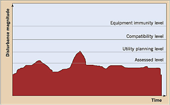

Steady-state power quality. The first category of characteristics refers to the quality of the normal voltage supplied to your facility. In other words, how much can the voltage magnitude vary from the nominal value? How distorted is the voltage? What is the unbalance between the 3-phase voltages? It's possible to quantify all of these characteristics and develop limits for the variations.
These are the power quality characteristics that have received the most attention from the standards developing committees. For instance, the European standard EN50160 provides minimum performance requirements for the electric supply in all of the steady-state power quality categories, which are evaluated using statistical procedures. Using statistics to characterize the supply's performance makes it possible to compare the results with the statistical characteristics of equipment immunity to power quality variations.
The objective is to define a performance level that can be achieved with a reasonable investment in the power system and will also be unlikely to cause equipment problems. This level is called the compatibility level and is defined with statistics. For example, it's common to define the compatibility level for performance evaluations as the level that may not be exceeded more than 5% of the time. In other words, there's a 95% probability that the level won't be exceeded. Fig. 1 above illustrates the compatibility level concept compared to a time trend of a steady-state power quality characteristic. Fig. 1 also shows several other important power quality levels, including the following:
  • Equipment immunity level
    Equipment performance may be negatively affected if this level is exceeded. It's also defined statistically. There should be some margin between the compatibility level for the supply and the equipment immunity level.
  • Utility planning level
    The electric utility will establish this level as its design objective. Usually, the utility sets the planning level somewhere below the compatibility level to help ensure it won't exceed the actual compatibility level. For example, the compatibility level for harmonic voltage distortion might be 5% but the planning level might be 4%, ensuring the 5% level isn't exceeded.
  • Assessed level
    This is the actual level that exists on the system. It's usually based on measurements. For example, the evaluation of performance for the European standards requires measurements over a one-week period. So the assessed level, used for comparison with the minimum performance requirements and based on the compatibility level, is the level exceeded for 5% of the measurements (one measured value every 10 min).
