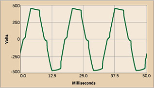

Catch the wave. Compared to DC motor drives, AC motor drives cause very few problems. However, poorly designed applications can result in power line voltage distortions, as shown in the flat-topped waves of Fig. 1.
These voltage distortions can cause problems for other equipment connected to the same power lines, resulting in erratic operation of controls, dimming of lights, and overheating motors operating across the line. The distribution transformers and cables feeding these drives will also experience additional heating, which reduces the power use of those components.
