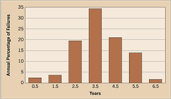

Today, the valve-regulated lead acid (VRLA) battery is commonly used at all UPS power levels. It's also the predominant battery used in manufacturing operations with a UPS system because it costs much less and requires much less space than conventional vented lead acid batteries (wet cells). But batteries, particularly VRLA batteries, are recognized as the UPS system component with the highest failure rate.
A paper titled “Increasing UPS Battery Life: Main Failure Modes, Charging, and Monitoring Solutions,” written by members of the R&D Advanced Technologies Team of MGE UPS Systems, details a study conducted on VRLA battery failures. Two methods were used. The first was a theoretical analysis of failure mode effects (FMECA) on a 10kVA, single-phase UPS, where battery behavior was evaluated in three life phases: charge, discharge, and charge maintenance. The second was a practical analysis of after-sales maintenance databases. The results were compared “for validation of main failure modes.” Using a database of 8,000 records, the study also highlighted the average elapsed time before the first battery maintenance operation, which included partial or total replacement of the battery. Fig. 1 presents the findings of the study.
Based on this failure data, you could expect a 240-cell battery system, which is the most common configuration for large UPS systems, to average five cell failures in the first year (2% of 240 cells), nine in the second (4%), 48 in the third (20%), and 84 in the fourth (35%). Since VRLA batteries predominantly fail open-circuit, any single-cell failure results in failure of the entire battery system. So the mean-time-between-failure (MTBF) of the entire battery system is measured in months or weeks rather than years (Sidebar “Calculating the MTBF of Battery Strings” above). Therefore, eliminating batteries improves overall reliability and eliminates the continuing costs associated with battery maintenance and replacement.

You can't calculate the MTBF of an entire UPS battery string by dividing the mean life of a cell by the number of cells in series (46 months ÷ 240 = 0.19 months) because the data from the MGE UPS Systems study indicates that the probability of failure of individual cells is far from constant over time. The MTBF will depend on the age distribution of cells in the UPS and therefore will be longer when the battery string is new and shorter once it's more than about three years old.
