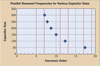

Special considerations are also very important for switched power factor correction banks. You must evaluate every step (capacitor size) to determine possible resonant conditions. The Figure at left shows a six-step capacitor bank versus harmonic resonant order. The red lines represent the orders to avoid, including the 5th, 7th, and 11th. If this same bank were designed as a harmonic filter, the parallel resonant point at any given stage would be equal to approximately the 3.5th harmonic — well below the 5th harmonic current, which is the lowest significant harmonic on this power system.
