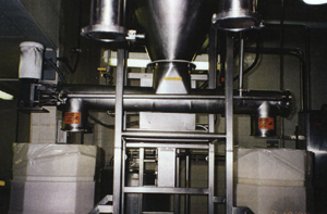

Setting the scene. The curd production line on which the victim was working processed milk into whey, which, when strained, left behind the curd that was then lifted to a holding hopper. Beneath the hopper was a short screw auger that would direct the curd to one of two barrel filling chutes, depending on which direction the auger turned. Every night at about midnight, the crew would shift to clean-up mode, using high-pressure steam and hot water to clean the cheese from every nook and cranny of the production machinery, as required by the USDA. The company had written instructions against hand cleaning and used equipment built with food grade polished welds to facilitate automated cleaning. But despite these precautions, the employees often found it necessary to reach up into the chutes to remove cheese that would stubbornly cling to the blades — a practice that wasn't approved by the company's cleaning policies (Photo 1).

Even though it wasn't required by the NEC, the presence of an electrically latching main power contactor, controlled by start-stop buttons on the barrel fill auger machine, would have certainly prevented this accident.
Because of the admission regarding the safety switch location, the electrical contractor's liability insurance company settled out of court for the full amount of the claim. The electrical contractor was no longer part of the suit, but its insurance company could recover any money received as a result of any percentage of liability on the equipment manufacturer's part. The case now focused on whether the lack of a latching relay was a design defect and, if so, the percentage of the responsibility for the faulty design the two defendants were liable for.
Deposition testimony showed that the cheese manufacturing industry is relatively small and isolated with only a few equipment suppliers who know the production procedures well. They know that daily cleanup and the accompanying lock-out/tag-out is universal. Their equipment is integrated with process controllers that can start equipment automatically. However, the one wild card is that despite the routine nature of cheese making, humans tend to introduce random variation in their behavior under such conditions. In this case, that random event was a careless disregard for lock-out/tag-out procedures. In the absence of universal engineering design standards, the art of prudent design would require the equipment manufacturer to anticipate this possibility and include a start-stop station in the barrel fill auger control panel mounted on the machine. These latching contactors are very common, yet aren't universally required or considered necessary by any codes or standards.
