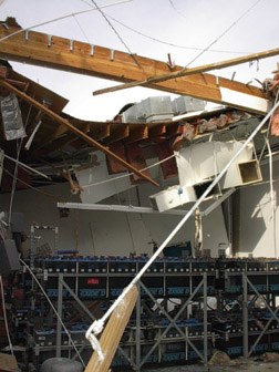

Hydrogen lurks. UPS systems are safe and reliable if you perform the required maintenance. In Photo 1 on page 26, see what can happen when you don't. Vented batteries have cost and performance advantages over valve regulated (VRLA) batteries. But you lose those advantages if you fail to do things like accommodate the small amounts of hydrogen these batteries emit.
In a battery room designed for vented batteries, the hydrogen theoretically doesn't accumulate. But in the real world, filters clog and fans fail. If some minor equipment failure renders the ventilation system inadequate, how will you know? And if you don't know, how can you take preventive action? Proper battery monitoring is the solution.
