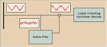

Active filters. These filters correct harmonic distortion levels by monitoring the current waveform that includes the nonlinear loads, and by creating a current waveform that results in cancellation of the harmonic components (Fig. 1). Several different control strategies are possible. You can design the system to cancel either individual harmonic components with different weightings or all of the harmonics in proportion to their level in the nonlinear load current. Active filters for commercial applications have the following advantages:
  • They can't be overloaded. Active filters provide correction only up to their rating, unlike passive filters, which will absorb harmonic currents from throughout the facility and even the distribution system, resulting in a real overloading concern.
  • They can be rated for partial correction of the harmonics based on the specific concerns. The active filter can be quite small because it doesn't have to compensate for all of the harmonic current. You don't have this flexibility with passive filters because they absorb as much current as possible.
  • They don't provide power factor correction. This reduces the size requirement for the active filter and is an advantage in commercial facilities where the loads already have a good displacement power factor.
  • They don't create resonance problems. Passive filters may actually magnify harmonic components other than the one for which they are tuned. This isn't a concern with active filters.
  • They can correct for all the harmonic components. Zig-zag transformers only correct the zero sequence harmonic components. You can employ other transformer connections to cancel other harmonic components, but this increases the cost of magnetic solutions.
