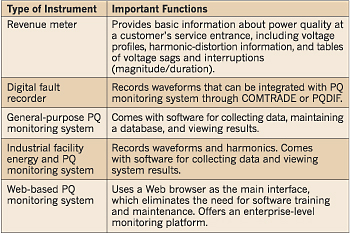

Permanently installed power quality monitors come with software and communications capabilities for data collection, data processing, and results presentations. The software maintains a database of system performance information you can access for real-time data or long term summaries. The Table offers some options in this category.
