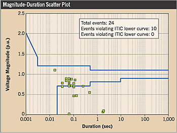

The main factor that determines whether voltage sags will affect your facility is the sensitivity of the equipment in your process. The sensitivity curve developed by the Information Technology Institute Council (ITIC) shows that computer equipment should be able to ride through short duration voltage sags if the voltage doesn't go below 70% (Fig. 1 above). For longer duration sags, voltages below 80% could affect the equipment. See “Ask the Experts” on page 52 for a more in-depth discussion of the ITIC curve.

From 1993 to 1995, EPRI conducted a major benchmarking project for utility distribution systems across the United States. Based on the results of this project, distribution utility customers can expect an average of about 18 events per year in which the minimum voltage goes below 70% (referred to as SARFI-70). This is much higher than the average number of outages a customer can expect, which is about 1.3.
Many utilities have used monitoring projects to provide their customers with better information about how many voltage sags to expect. Facility engineers need this information to evaluate the economics of different alternatives for improving the facility performance during these voltage sag events. When characterizing the expected performance, you should separate the voltage sags caused by transmission system faults from those caused by distribution system faults (Fig. 2). This will help you understand where your investments can help improve performance, and it may also indicate possible solutions on the utility side of the meter.
