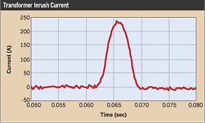

One of our customers has experienced tripping of an upstream breaker when turning on a specific machine. The breaker is rated 250A, 3-pole. We suspected that a high inrush current condition on a transformer caused the tripping. We measured a nominal inrush current of 80A. Is there an inrush current limiter available for such a high current?
McGranaghan and Arshad Mansoor's answer: Transformer inrush current can cause breakers to trip. The problem can be particularly severe with smaller transformers, such as control transformers, that can have peak inrush currents 40 times the normal load current. In many cases, this current level is high enough to blow fuses or trip breakers. The Figure shows a peak inrush current of about 230A, which led to fuse blowing on a 1.5kVA, 230V, 1:1 isolation transformer with a nominal current of 6.8A.
There are multiple solutions to combat this problem:
  • You can use time delay fuses to avoid nuisance tripping. Because the inrush current is short in duration, the time delay prevents such events.
  • You can also use high inrush current breakers, which are designed specifically to prevent inrush current tripping. They're best suited for protecting circuits likely to encounter high-inrush loads as much as 30 times rated current for one-half cycle at 60 Hz. The high-inrush design eliminates nuisance tripping without the need for breaker derating, thereby maintaining tight tolerances for overall circuit protection.
