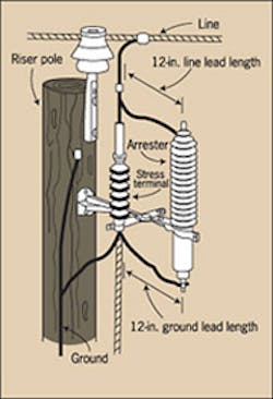

Surge arrester lead length. Lead length is a very important consideration in designing and/or installing the connections between pole-mounted surge arresters and medium-voltage (MV) cable terminators. PMs calculated from arrester catalog data don't include allowances for this variable.
Lead length is the combined length of the line lead and ground lead length in series with the arrester and in parallel with the device or cable being protected. For example, in Fig. 1 below, we see the arrester mounted near the MV cable stress termination, a line lead length of 12 inches, and a ground lead length also of 12 inches. So, the total arrester lead length is 24 inches.
The commonly accepted method of determining the effect of lead length on arrester operation is to use an inductance of 0.4 microHenries per foot of lead length and a lightning current rate-of-rise of 4000A per microsecond to determine L × di/dt voltage drop of the installation. Using this method, calculations show a 1.67kV addition to the discharge voltage of the arrester per foot of arrester lead length. This increase in discharge voltage actually reduces the extent of PM on the system.
In the installation shown in Fig. 1, the effective 10kV IR discharge voltage rating of the riser-pole arrester is increased from 52kV to 55.2kV as a result of the addition of 24 inches of lead length.
While this increase may appear relatively small, it's critical when you consider the voltage-doubling effect, as previously mentioned. Here, voltage doubling will reduce the BIL PM from approximately 17% to almost 12%. As you can see, it's very important that you keep the arrester lead length as short as possible in all arrester installations, especially in critical situations such as cable protection.
Figure 2 below shows a similar installation except that we take the line lead directly to the arrester before going to the MV cable stress termination. This virtually eliminates all arrester lead length on the line side since, by definition, no lead is in series with the arrester while being in parallel with the cable termination. The total lead length is reduced to 12 inches, which is the length of the ground lead.
Figure 3 below carries the length reduction one step further. Here, the arrester is mounted between the MV cable stress termination and the pole ground. This installation has zero line and zero ground lead length. As such, lead length has no detrimental effect on the protective characteristics of this installation.
