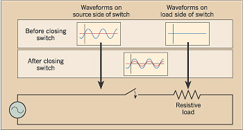

Switching a ‘normal’ load. Energizing a load begins with a switching device in the open position. When the switch is closed, the load is connected to the rest of the energized system and whatever voltage magnitude exists on the switch's source side will be applied across the load at the instant of contact touch. If the load is a pure resistance, this isn't a problem. The voltage across the resistance (shown in blue in Fig. 1 above) will give rise to a current flow (shown in red) according to Ohm's Law.
Fig. 1 also shows the switch closing just as the voltage waveform crosses zero. This is the preferred time of closing. If the switch closes at any other time, the voltage and current waveforms on the load side of the switch will experience a sudden “jump” or discontinuity. The rapidly rising voltage and current during this transient period adversely affects the system's power quality. (Part 2 of this article, which will appear in next month's issue, will explore this phenomenon in detail.)
