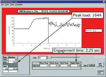

One of the verification steps during the root cause investigation was to determine the clutch engagement time. The motor analysis team (MAT) proposed monitoring the current on the motor to attempt to determine the clutch engagement time. The MAT used the current analysis in-rush test function on the analyzer to capture the motor current data. From this data they were able to calculate the engagement time for the clutch. The initial test indicated a very rapid clutch engagement time — about 2.25 sec. — similar to an across-the-line start for the motor and clutch (Fig. 1).
With the assistance of operations, maintenance, and the plant support engineering staff, the team adjusted the clutch engagement time back to the manufacturer's specification of between 5 sec. and 7 sec. (Fig. 2). Since this adjustment, the rod mills haven't experienced a shaft breakage.
