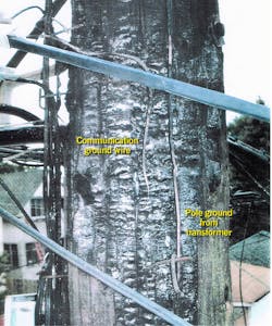

At approximately the level where the phone system ground was clamped to the pole ground, there was evidence of a small fire, and the conductors had melted — opening the connection to the phone system ground as well as the pole ground below it. The only ground connection from the transformer had been through the communication cable messenger wire, which is not designed to carry power system ground current. The conductor or clamp most likely melted open at some previous time due to the excessive current.
As a result of all of the above, the section of pole ground from the burned area to the point where it was cut near the bottom of the pole was completely disconnected and electrically dead. The phone system ground was disconnected from the pole ground. The power line neutral was disconnected from the pole ground (see Photo 1, Photo 2, and Photo 3).
Photo 1. The accident area on the pole shows evidence of a small fire.
The transformer ground conductor ran down to the area of the pole where the fire occurred, but was unconnected at that location. Without a ground connection, this conductor was energized at a high voltage as it carried ground current from the primary system of the transformer. When the victim wrapped his arm around the pole, he made contact with this conductor, which delivered the electric shock.
Photo 2. The neutral jumper problem area on the pole.

Photo 3. The pole ground had most likely been compromised by vandals.
