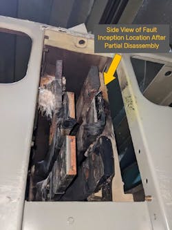

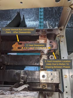

Photo 1 shows that the A-phase bus experienced a high degree of heating between the vertical bus connection and the adjacent horizontal bus connection where the eventual failure occurred. This was apparently due to the high oxidation level on the bus bar exacerbated by the lack of tin plating.
If there were a loose vertical bus connection, it likely would have dissipated heat into the nearby horizontal connection that was thermally and electrically insulated with vinyl tape. This allowed heat to accumulate within this portion of the bus.
At this point, the A-phase bus bar got hot enough to allow the tin plating to melt, and molten tin dripped down on top of the adjacent B-phase bus. This would have effectively created a conductive path between phases, allowing an inadvertent electrical connection, subsequent ionization of surrounding air, and an arc flash event (Photo 2).
The likely root cause of this failure was determined to be loose vertical bus connections that were not recognized during the initial commissioning of the MCC three years prior. As part of the investigation, previous maintenance records on the failed equipment were requested. The client stated that no previous maintenance had been performed, and no maintenance records existed. This was a key contributor to the failure. The deficiency may have been recognized before the eventual catastrophic failure if contact resistance testing had been performed during maintenance.
