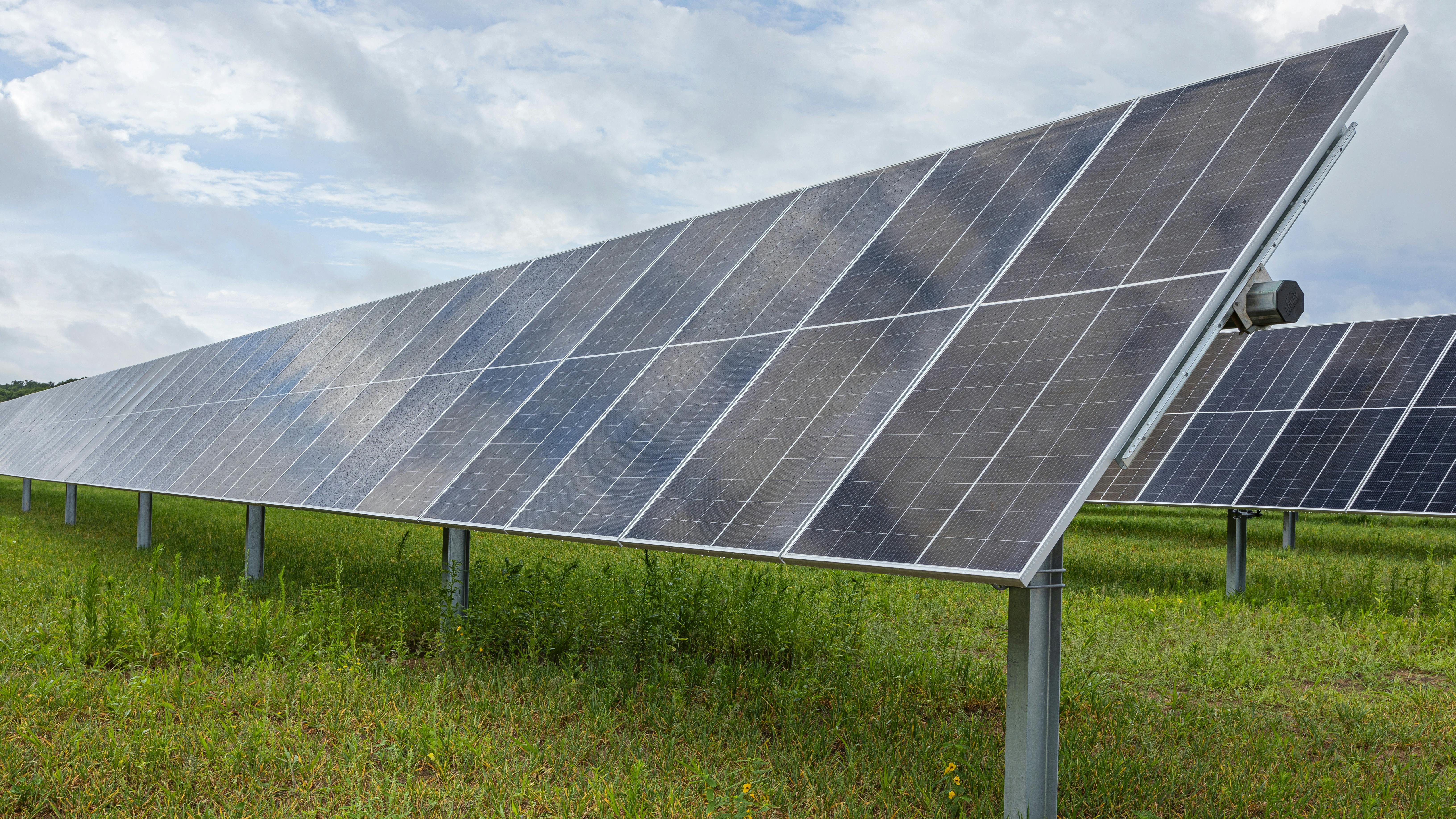

As demand for new solar farms continues to rise, so does a host of challenges including community pushback, equipment and labor shortages, and a congested grid. Here’s how the industry is overcoming them.
Interconnection is the process of hooking a generation source to the grid. That term also describes the delicate relationship between the land, labor, lines, zoning, grid capacity, and equipment that make up a solar farm. If just one piece isn’t in place, the whole project falls apart. Sometimes multiple pieces are absent simultaneously, while other times putting together a project can feel like a game of Whac-A-Mole.
