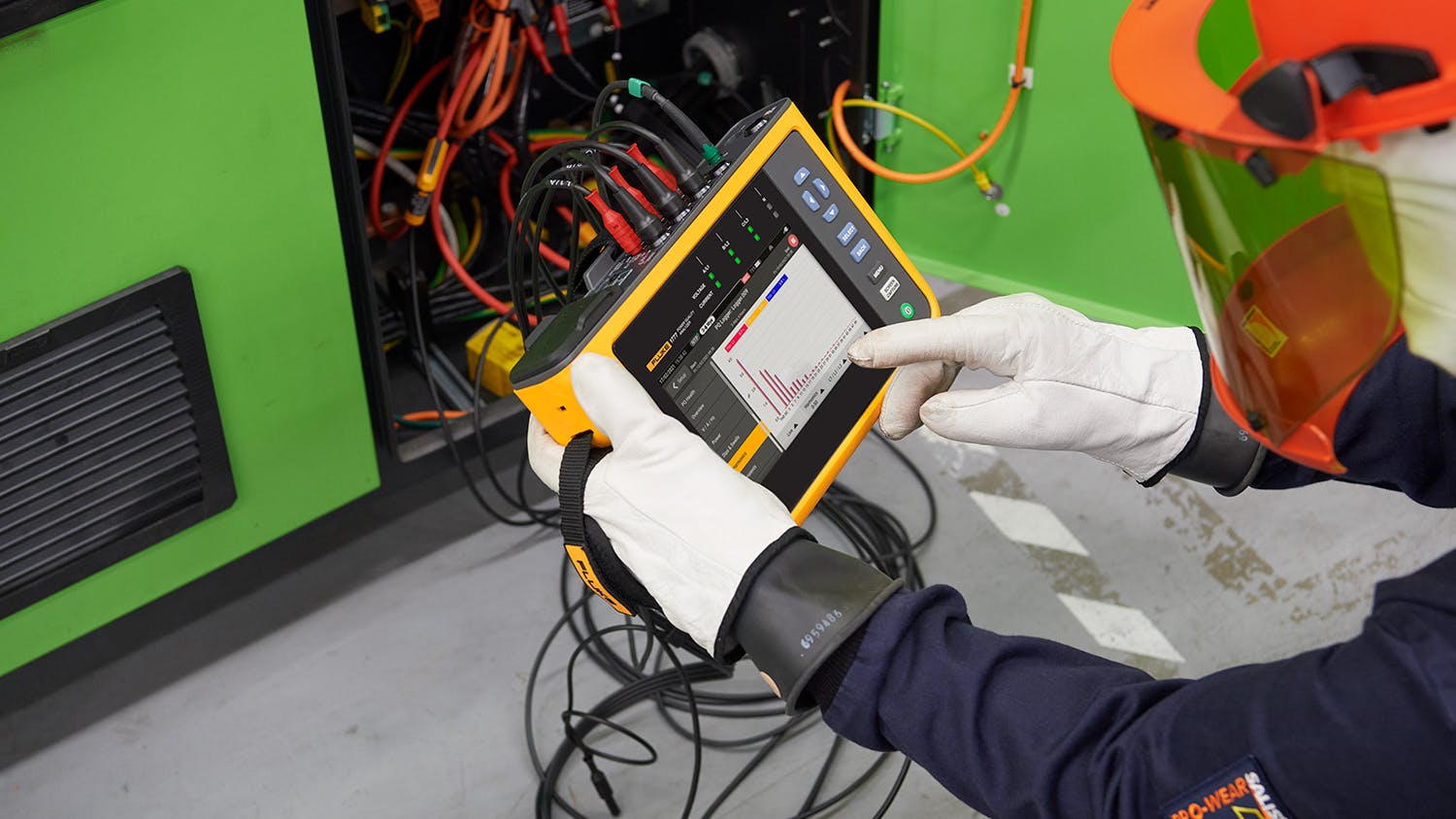

Photo 2. Placing a power quality analyzer on a circuit is a good way to record disturbances in the system over time.

Once you have found an issue, you’ll want to start with the issues you’re seeing, properly identifying the root cause of the problem, and isolating the source. Start by measuring with a clamp meter that can indicate power quality issues (Photo 1). A tool like this can help indicate total harmonic distortion (THD) and show all harmonics present. THD for voltage should not exceed 5% to 6%, and THD for current will run considerably higher.
Excessive THD for voltage means any number of problems could be occurring, and you should continue to get to the bottom of them so corrective action can be taken. To further investigate the magnitude and effects of the individual harmonics, you’ll need more detailed information from a more powerful tool, like a power quality analyzer (Photo 2).
A power quality analyzer can record disturbances, like harmonics, in your line power by recording and monitoring the power quality over some time. Your analyzer can pick up all sorts of potential problems like dips and swells, wasted energy and electrical disturbances, or other issues that can cause the malfunction of control circuits.
