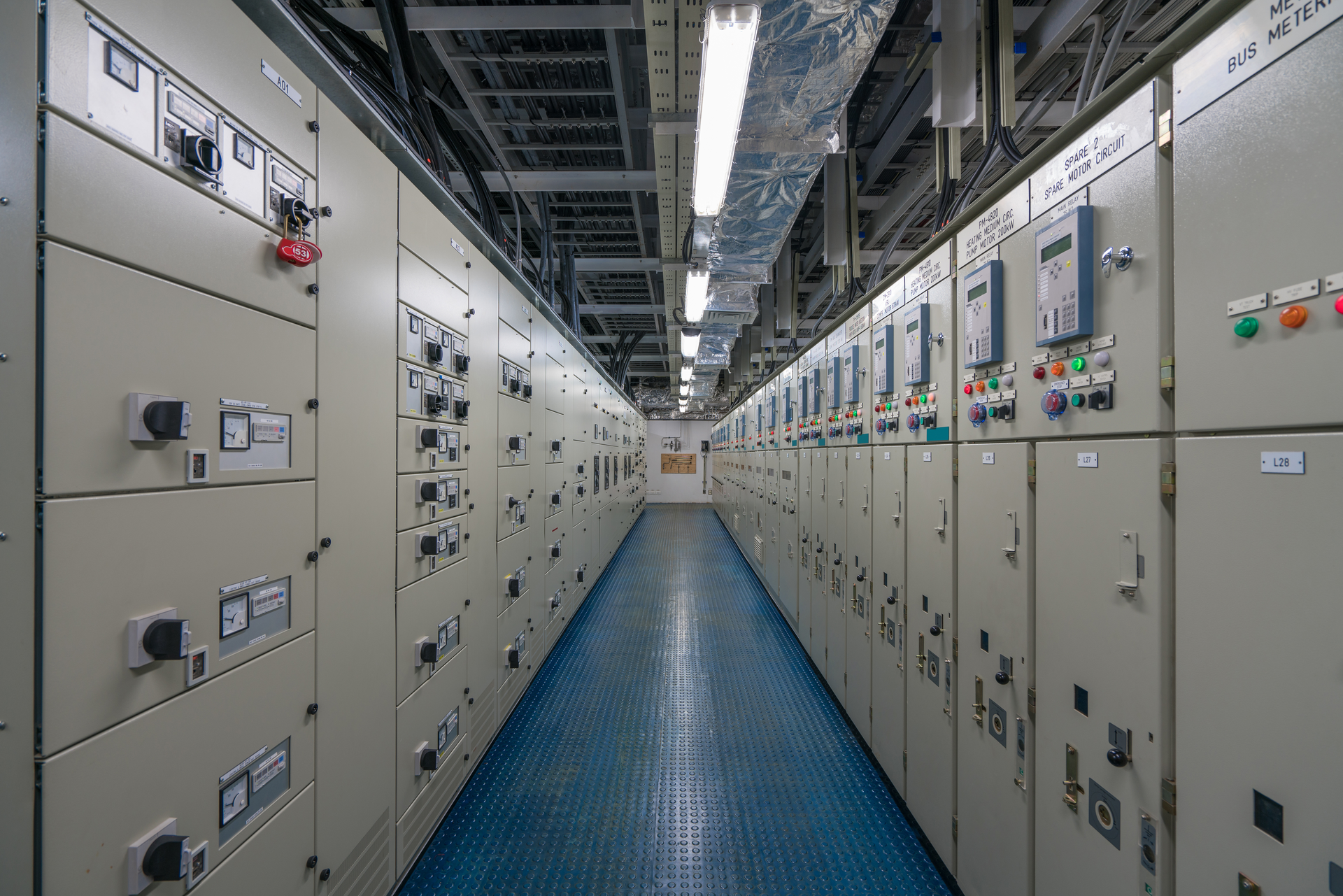

© Pichit Boonhuad | Dreamstime.com
Switchgear room
