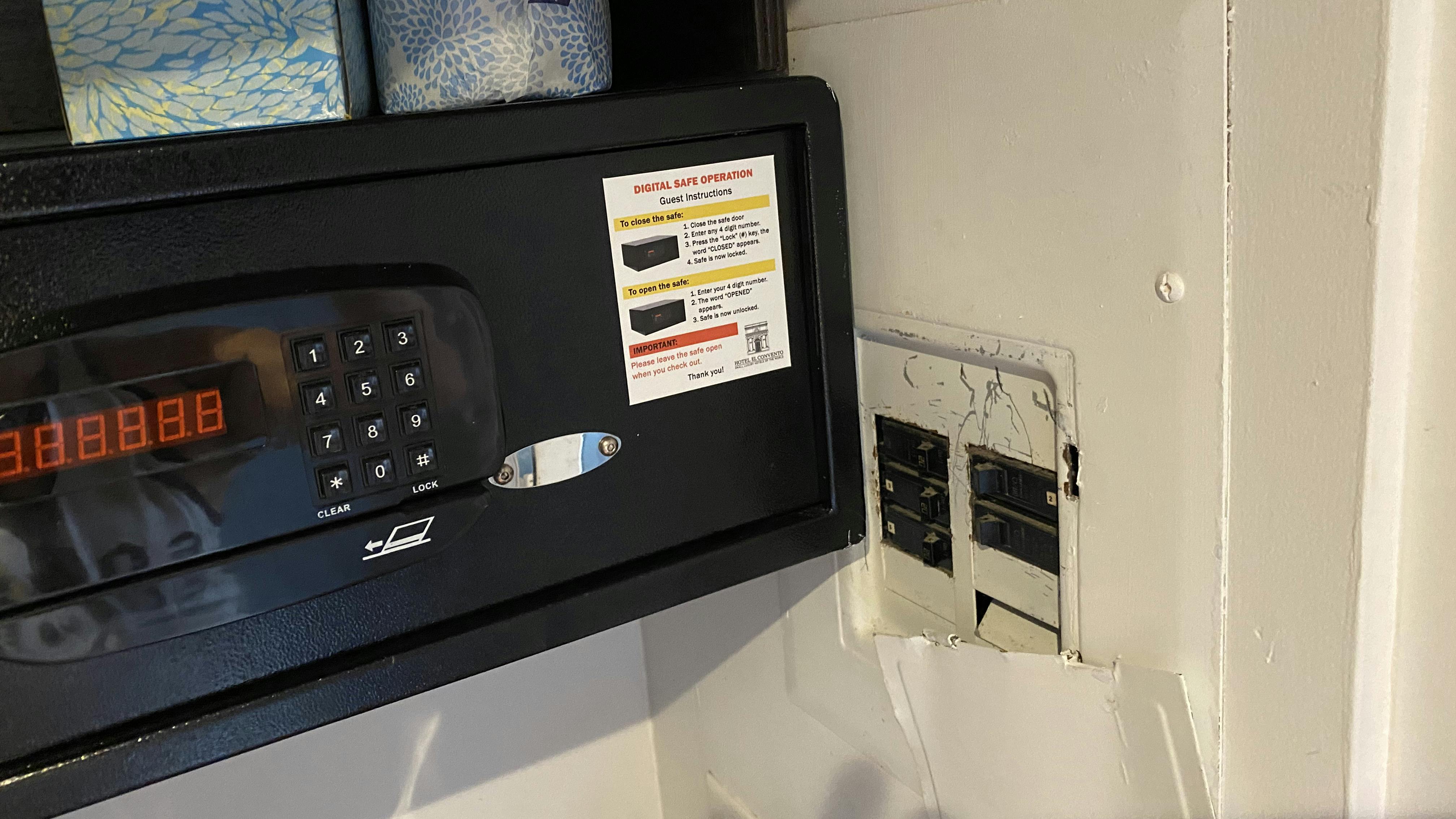

I spotted this enclosed panelboard during a recent stay at a hotel. The room safe was installed in a position that completely obstructs some of the cover screws for the panelboard enclosure. That safe would probably need to be taken out before you could remove the screws for panelboard cover, which isn’t cool! It’s also not up to Code.
The working space required by Sec.110.26(A) is obstructed by the safe and the shelves above the safe. One of the circuit breaker blanks is partially pried out of the panelboard cover. This increases the risk of shock as curious people, including kids, could easily stick a finger in that opening and make contact with the energized terminals of busbars inside the enclosure. Section 408.7 requires unused circuit breaker openings to be closed up in a manner that provides protection equivalent to the enclosure walls. Section 110.27(A) requires live parts to be guarded against accidental contact by approved enclosures when not protected by the other means specified in Sec. 110.27(A)(1) through (A)(4). None of those other means is applicable here.
Additionally, it appears as though the door on the cover, which is normally used to protect the circuit breakers, was intentionally ripped off its hinges. I’m guessing that was probably done to reset a tripped circuit breaker. I would say a broken door violates Sec. 110.12(B) because the integrity and mechanical strength of the enclosure has been compromised.
