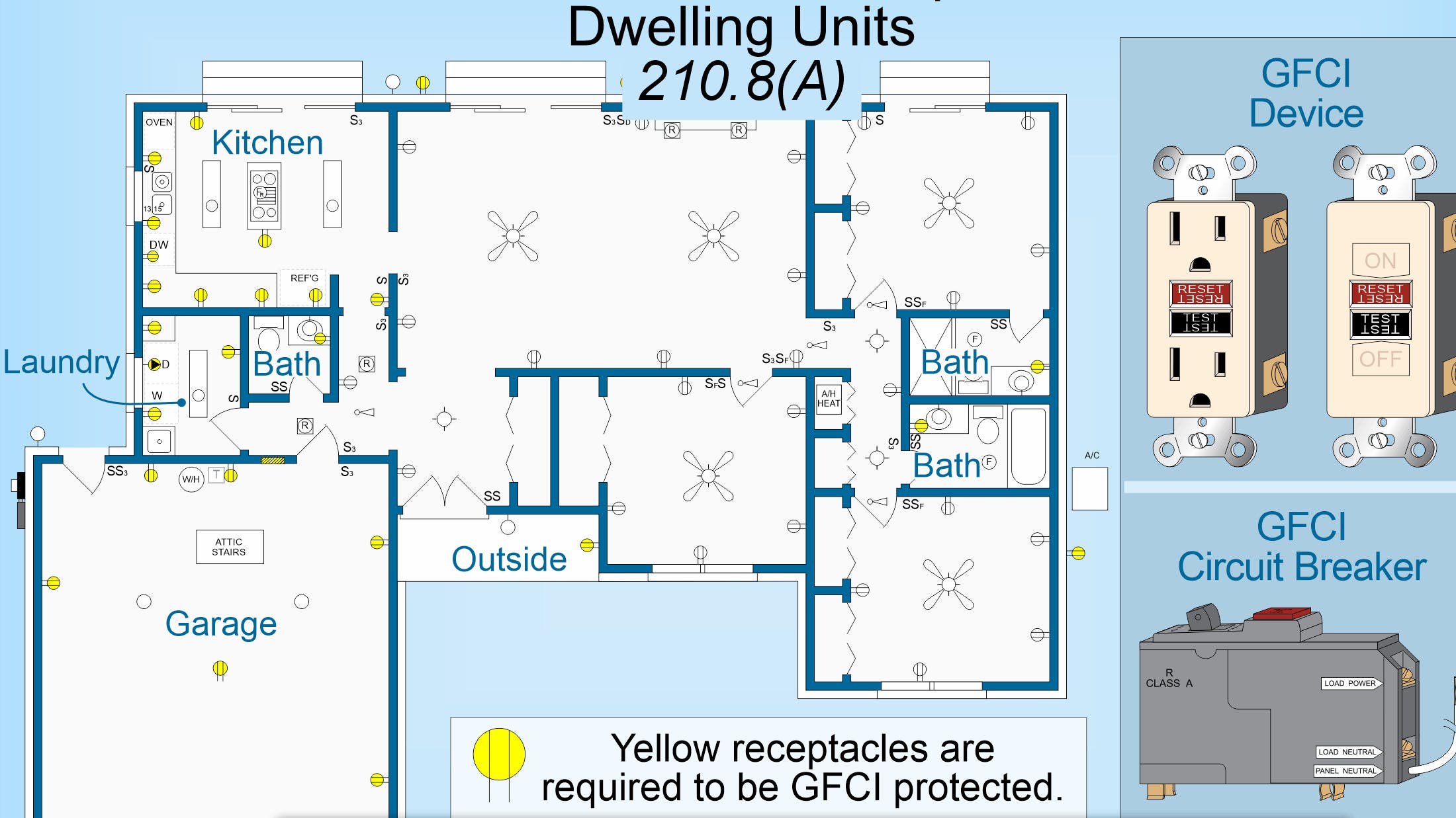

GFCI protection for dwellings
GFCI protection must be provided as required in Sec. 210.8(A) through (F). GFCI protective devices must be in a readily accessible location.
You can provide the GFCI protection using either a GFCI circuit breaker or a GFCI receptacle. To apply Sec. 210.8(A)(8) or (10), Sec. 210.8(B)(7), (13), and (15), the distance you measure from the sink or bathtub/shower is the shortest path the power-supply cord connected to the receptacle will follow without piercing a floor, wall, ceiling, or fixed barrier.
With the 2023 revision, the reference to windows and doors was removed to ensure GFCI protection for receptacles within the measured distance as required in Sec. 210.8 even if the measurement line passes through a window or door.
A GFCI circuit breaker provides ground-fault protection starting at the breaker, so the entire circuit has ground-fault protection. A GFCI receptacle provides ground-fault protection for whatever is plugged into it; it has load-side terminals that provide downstream protection for any other receptacle(s) or device(s) on the circuit.
Receptacles installed in the following dwelling unit locations must be GFCI protected — and the GFCI device must be in a readily accessible location (Sec. 210.24(A), as shown in Fig. 1).
(1) Bathrooms.
(2) Garages and accessory buildings.
(3) Outdoors.
(4) Crawl spaces (at or below grade).
(5) Basements.
(6) Kitchens.
Traditionally, this requirement applied only to kitchen countertop receptacles, but now any cord- and plug-connected appliance in the kitchen, such as the range receptacle, refrigerator receptacle, disposal receptacle, and microwave receptacle, now require GFCI protection.
(7) Food or beverage preparation or cooking areas.
(8) Sinks (receptacles within 6 ft of the top inside edge of the bowl of a dwelling unit sink).
(9) Boathouses.
The Code does not require installing a receptacle in a boathouse, but any that are in a boathouse must be GFCI protected.
(10) Bathtubs or shower stalls (receptacles within 6 ft of the outside edge of a bathtub or shower stall not installed within a bathroom).
(11) Laundry areas.
(12) Damp and Wet Locations Indoors.
